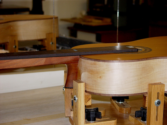

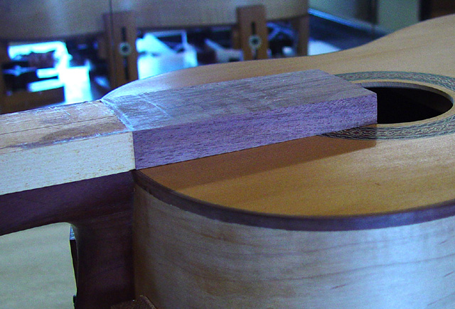

I have thicknessed, slotted, and tapered the fretboard for my first guitar. The underside of the fretboard from the 12th fret to the soundhole needs to be relieved to match the contour of the slightly arched top.
My books call for hand planing the ebony fretboard, but I'm not very confident about my skill, so can I achieve the same result by dragging a sheet of sandpaper between the guitar top and the fretboard?

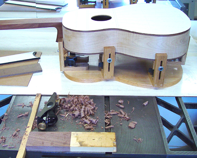

Thanks to all. I took John's advice and sharpened my block plane and started practicing on a Walnut/Poplar leftover piece from an IncraJig project.
In no time at all, I am getting pretty good results.
I will make a few more trials on scrap hardwood, then re-sharpen and give the ebony a try.
